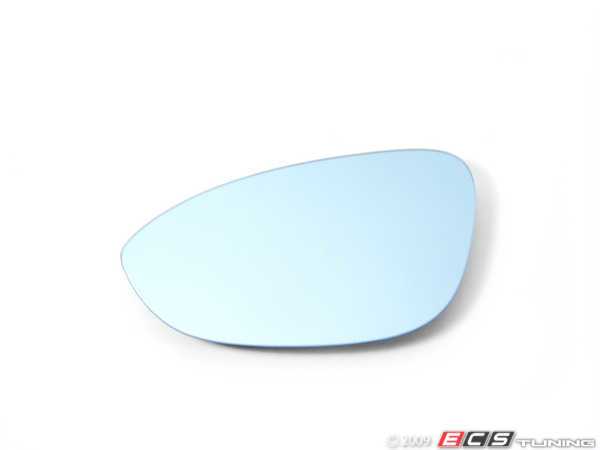

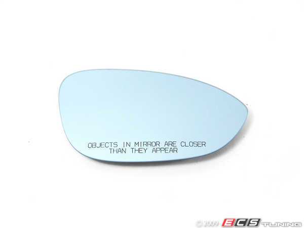

Originally Posted by NocturnalEVO View Post
Follow up question...
why does my passenger mirror keep this anti glare thing on?
Everything looks brown and it looks nasty lol
any way to just have it clear?
That's a sign that the auto dim mirror glass is shot
There is a liquid inside the glass that makes the mirror dim & then go back to clear upon application of electricity - same as your rearview mirror (when those go bad you need to replace ASAP as the liquid will eventually leak out onto your dash/console and mark it permanently).
The seller had to know the glass on this side was no good - kinda coincidental that it 'just happened' when you installed
You would be better off just buying the plain non auto dim blue tinted mirror glass at this point since you aren't using the auto dim function anyway.
They are less expensive & you'll never have the problem again. That's what I have in my M3 mirrors...
#51168046507 MIRROR GLAS HEATED PLANE LEFT $58.63
http://www.ecstuning.com/Search/Site...6507/ES242775/
#51168046508 MIRROR GLAS HEATED CONVEX RIGHT $87.94
http://www.ecstuning.com/Search/Site...6508/ES242776/
You can get them cheaper @
www.getbmwparts.com
www.bmwparts4u.com
www.bmwpartspros.com
I just used ECS as an example
