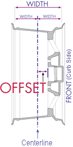

I'm no expert, but here's what the offset is all about - basically curbside offset from center:
All other things being equal on a wheel, offset determines stance inside the wheel wells. The bigger the positive offset number, the more the wheel will be tucked inside the well. The smaller the positive offset, the more the wheel will be pushed out toward the fender lip.
I think of it as [big number pulls my wheel away from the curb], and [small number pushes it toward the curb].
I hear ppl saying "just get smaller offset". But that doesn't account for taste in wheels. You can't just say "I want this kind of wheel, with *that* offset". Wheel offsets are a function of wheel style. You can easily see that a deeper dish wheel will have a smaller offset. Therefore, it's all in taste.
Some manufacturers might make the same style wheel with different offsets (basically, different hubs - kind of like built-in spacers), but not all. When you pick out your wheels, see what the options are.
In an ideal world, you don't run spacers. But once you get the wheels you really want, sometimes you will need spacers to get the desired stance.
Tirerack has a decent explanation: http://www.tirerack.com/wheels/tech/...jsp?techid=101
Hope this helps.
On my car, I wanted staggered 359s. I really like them but I'm considering spacers to push the rears out toward the fender lip.
BTW... "et" means the same as "offset; it's just the German equivalent.
