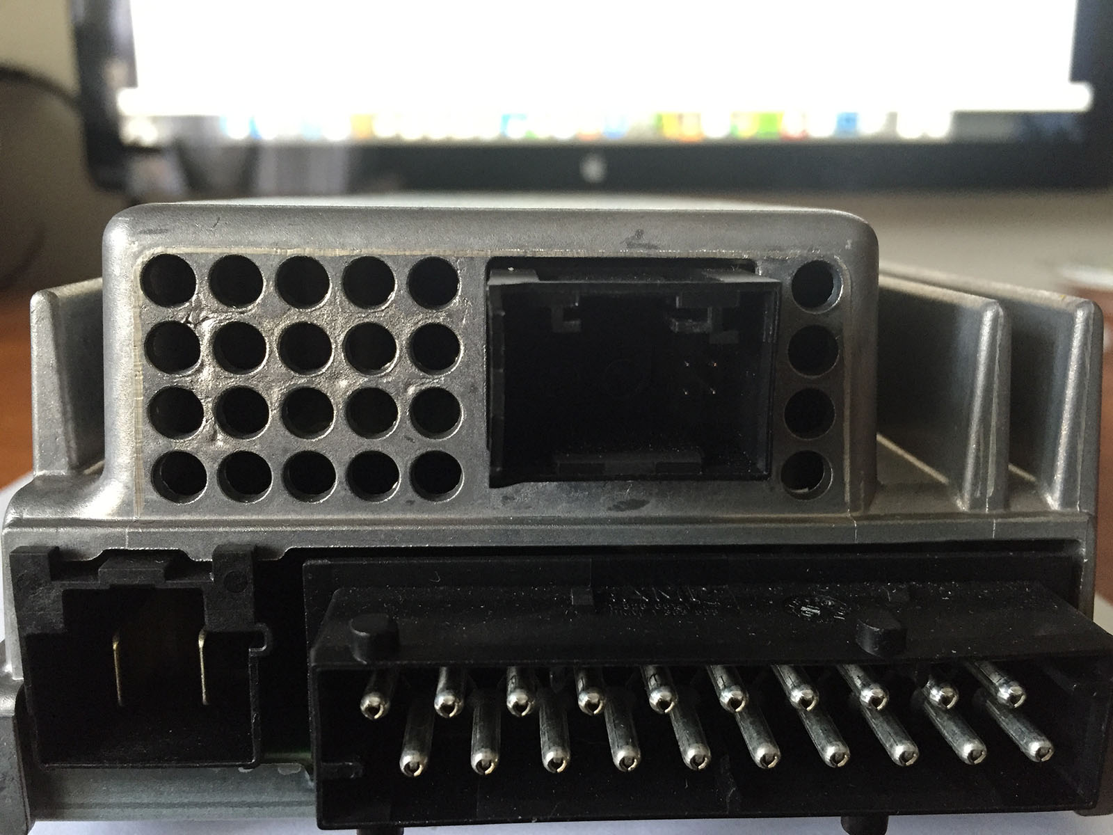

      07-21-2015, 01:15 AM   #8
reisf
reisf's Avatar
143
525
Drives: LBB M2
Join Date: Sep 2014
Location: Sydney, Australia
Sorry to resurrect this thread but can anyone confirm whether the power comes from the 2 pin blade socket, or in the 20 pin connector (pin 10 12v, pin 20 ground).
I'm doing the same thing at the moment, could the power just not come from the battery with an inline-fuse?
